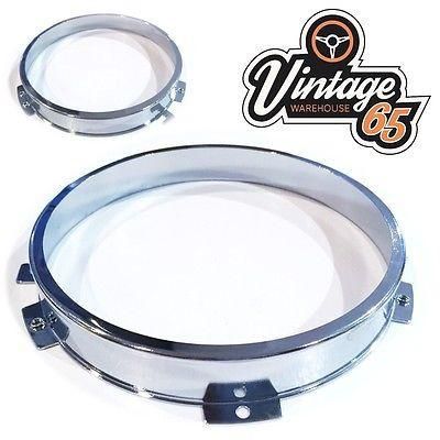

Trying to find the right bezels is proving a nightmare! universal ones don't have the lugs in the right place so far. Hopefully I will win and then post a write up to save people the trouble in future.

I'm hoping I can come up with a solution for ever so we can all avoid this trying to find increasingly elusive headlights :)
It looks like I should be able to fit universal rings like this so we can just buy generic 5 3/4" lights
the tabs on the retainer ring are in the wrong place for it to just work with the original carello backing bowls, but that said, the backing bowl tabs are broad enough that it should be possible to drill new holes to allow these to fit and use m3 nuts to hold them in place.
This isn't perfect because these universal rings don't have a rolled edge to the bezel, but it's a start. I'm going to try my luck and see if I can find a company that can fabricate new rings based off the originals that were part of the lamp assemble.

I caved and ordered a set of original headlight rings - so if I were to summarise my trying out the vintagewarehouse65 setup -
  • If you can live without the underbonnet adjustment, you can buy the complete kit and backing bowls and it'll work no problem with universal chrome rings, universal headlights and backing bowls, and you'll never have a problem getting hold of them again
  • If you want to keep the underbonnet adjusters, you need to keep your original backing bowls. Universal headlights will fit in these, and you can either use original chrome rings, or you can use universal chrome rings but if you do, you will need to drill new holes in the backing bowls as the universal rings fixing points don't quite match the original locations - and you'll need to use nut / bolt arrangements rather than the original threaded bolt holes
I personally wanted to keep the underbonnet adjustment, so kept the original backing bowls. The fixings were all pretty much balls of rust so I took the bowls + lights complete out of the car and did them all on the bench, which was much easier. If you're using universal rings you'll need to take that approach anyway, unless you go the whole hog and weld captive nuts into the newly drilled backing plate holes. On my original backing bowls the threaded bolt holes had rusted away so I had to fit nuts on the back - my hint for that, make sure you have the light lens vertical because you'll never get it adjusted again with it still in the car!

For the universal rings, that is what I have on the car with original bowls. They are fixed on with self tappers, they came to me like that, I just replaced the screws with stainless ones. This makes the whole job a lot simpler than trying to fix nuts and bolts.
Peter
That would be more sensible - I guess I didn't think of it as the originals used bolts rather than screws and the kit I ordered came with bolts
