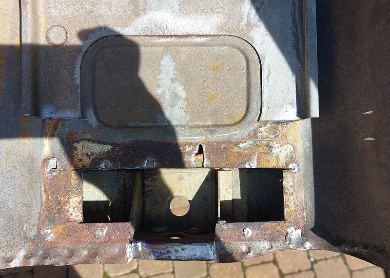

Springtime so it must be time for another update!
Like I said, new metal incoming and it looks pretty good
Onto the other side and same again except the cross-member studs previously stripped and had been retapped to M9 so needed to be replaced.
Voila
I had to remake the brake hose bracket
And weld it on

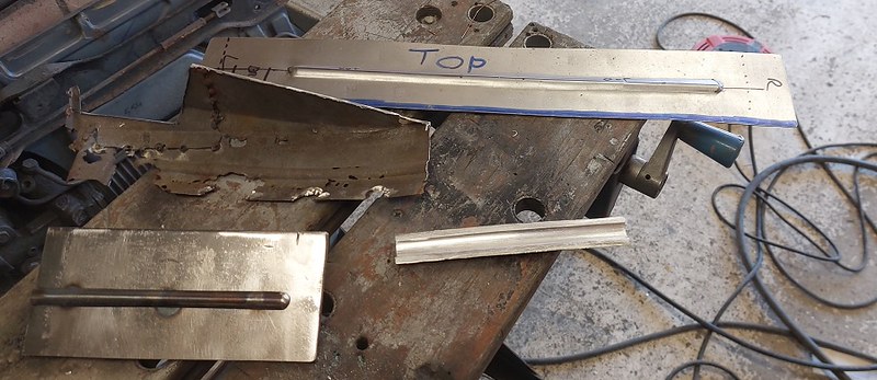

Rusty sections cut off the floor panel - first job recreate the flange where it fixes to the chassis rail - I bought a cheap shrinker / stretcher to help with this,
This is the bit with the chamfered section. No it's not exactly the same  - you try making a 45 + 45 angle that curves and tapers !
However I did get the profile of perimeter the same as it was
The filet piece has a rib in it, quite a pronounced one. I made a tool with some 12mm rod and 14mm I'd tube slit lengthways. It did the job well. More basic metal bashing made flare for the drain hole (not yet done in this pic)
A bit of bending and welding and this is the finished article - not fully welded in place which is why some of the gaps look big. The bottom of the fillet panel sits nicely in the outer wing which will give me a reference point when I replace that.

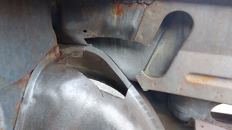

The inner wing looked superficially OK but was wafer thin
Mark's repair sections are for a coupe and don't quite work with the deeper spider sills. A lot better than nothing though
Check panel fit - very good
And then replace the inner wing in sections
Looks good but I got it in very slightly the wrong position  - I had to slit it to get the wing back on. Annoying but it fits.
