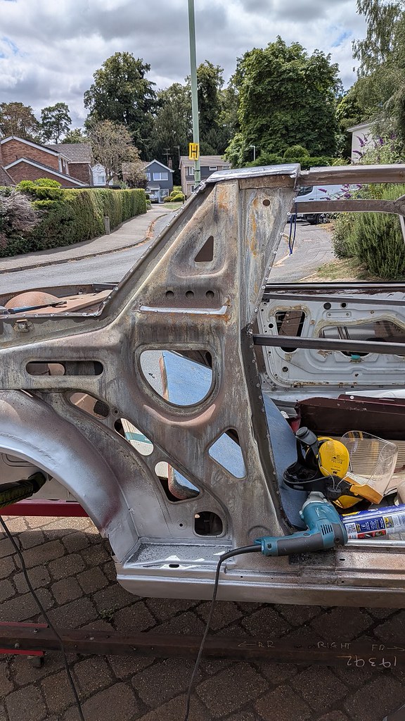

Somehow I missed a big chunk of weldporn on the rear offside sill. I know you hate to miss out so here it is a little out of sequence.
Before pics  - about as good as the rest of it.
Start chopping
First repair piece
Snug fit
And new corner piece made and fitted
Plated in the corner
More cutting left me with this
Which needed this monster section
I missed pictures of the sill being refitted so you'll have to imaging it.
On to the inside to replace the U section which was rotten

A quick update today. After a short break for holidays etc I was back on the car today turning my attention to the rear.
The offside rear turret is largely OK but had two holes one of them here:
I thought about patching it from the inside but access is pretty poor so I decided to do it properly from the other side. Sadly the turret strengthening plate is in the way
After removing a lot of spot welds this horror was found behind it
The bottom part of which forms the outside wall of the rear chassis leg. Not what you want to see. Thankfully it was localised only to behind the strengthening plate and the chassis leg itself is fine.
I conclude that the strengthening plate wasn't seam sealed which allowed moisture to get between it and the metal underneath where it sat eating it away.  New metal incoming  - but not today.

Springtime so it must be time for another update!
Like I said, new metal incoming and it looks pretty good
Onto the other side and same again except the cross-member studs previously stripped and had been retapped to M9 so needed to be replaced.
Voila
I had to remake the brake hose bracket
And weld it on
Onto the O/S Strut top. Complicated by the reinforcing plate underneath and the general mess of panels which meant I had to cut a lot out to be able to weld to good metal - there's a box section here in the wing making it effectively double skinned so you can't get to it from the outside either.
Repaired fillet for the upper bit that I cut out.
Went in well
Then the new metal
And the reinforcement panel underneath
The other bits I cut out put back in place
Now the OS boot floor panel. This was in a bad way, had been 'repaired' before and is way more complex than it needs to be. A curved edge with a flange to joint the fillet panel underneath is fair enough but why give it a tapered chamfered section near where the tank vent hoses go through?
The fillet panel was quite frilly too.
So out it all came
Small patch in the inner wing
Rusty sections cut off the floor panel - first job recreate the flange where it fixes to the chassis rail - I bought a cheap shrinker / stretcher to help with this,
This is the bit with the chamfered section. No it's not exactly the same  - you try making a 45 + 45 angle that curves and tapers !
However I did get the profile of perimeter the same as it was
The filet piece has a rib in it, quite a pronounced one. I made a tool with some 12mm rod and 14mm I'd tube slit lengthways. It did the job well. More basic metal bashing made flare for the drain hole (not yet done in this pic)
A bit of bending and welding and this is the finished article - not fully welded in place which is why some of the gaps look big. The bottom of the fillet panel sits nicely in the outer wing which will give me a reference point when I replace that.
When I'm doing this sometimes I wonder about the quality or strength of the work. It helps to remind myself of what the original build quality was like. This is some of the factory welding by Zagato !

I know I need to update a load of links but since there'd not been any new pictures for a year I thought it high time. Rest assured work is progressing.
Having done the boot floor on the right side it was time to tackle the left
Didn't look too bad....
Eeeek!
Not much better upside down either
You can also see the crude patch (or half of it) to 'repair' the bit where wing and valence joined
This bit was awkward
Came out OK
Bottom edge made with the tooling I made for the other side
The exhaust cut out needed some TLC too
Again happy with that
Next challenge to repair this patch properly. Lots of curved lips and corners here - and look at the angle of the wing compared to the boot! That's from when it was previously replaced back in the day
Yuck
Snip
Top piece
And done
Just needs a skim of filler after the primer is done
« Last Edit: July 29, 2026, 09:04:23 PM by HFStuart »
Offline HFStuart
  • Legendary Member
  • Posts: 2084
  • Country: gb
Re: Spider refurbishment
« Reply #75 on: July 29, 2026, 09:22:11 PM »
Time to attack the rear wings
There's a lot of reinforcement behind these - mostly in 1.5 or 2mm steel. Very robust indeed.
The inner wing looked superficially OK but was wafer thin
Mark's repair sections are for a coupe and don't quite work with the deeper spider sills. A lot better than nothing though
Check panel fit - very good
And then replace the inner wing in sections
Looks good but I got it in very slightly the wrong position  - I had to slit it to get the wing back on. Annoying but it fits.
The offside inner wing looked much the same as the nearside but in fact was much better - just needed the edges repairing
I've just about got the hand of this welding lark...(any professional welders out there that may care to say otherwise can do one!)
Done
Old wing off  - again lots of structure here
You'd think having a genuine panel would ensure it fits.
You'd be wrong they're handbuilt so while it might have gone together on a jig on the line - I had to unpick it
I'll weld it back together once the alignment of the wings and boot is done  - for which I'll need the rear lights!
Next steps are a lot of faff to line the panels up correctly, remake the bottom of the right inner wheel arch which needs the outer as a reference and then replace the curved corners of the valence. After that it's just the bulkhead for the power steering and it's errrr... done!
